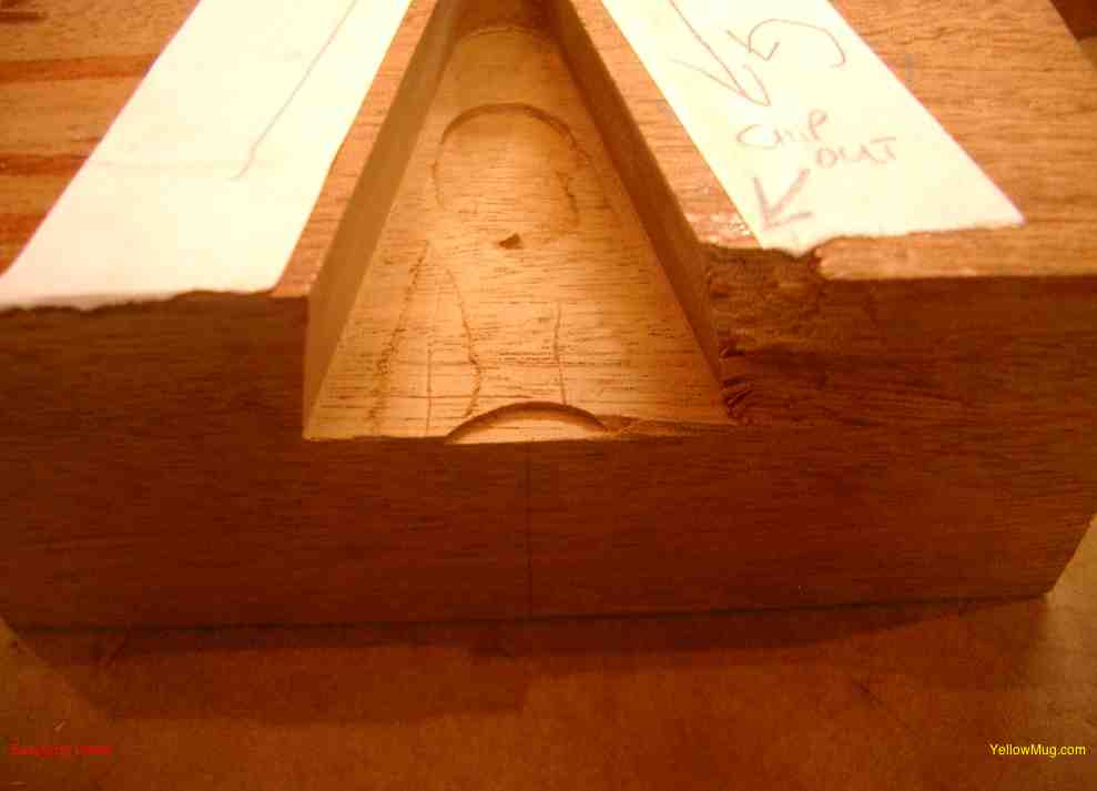

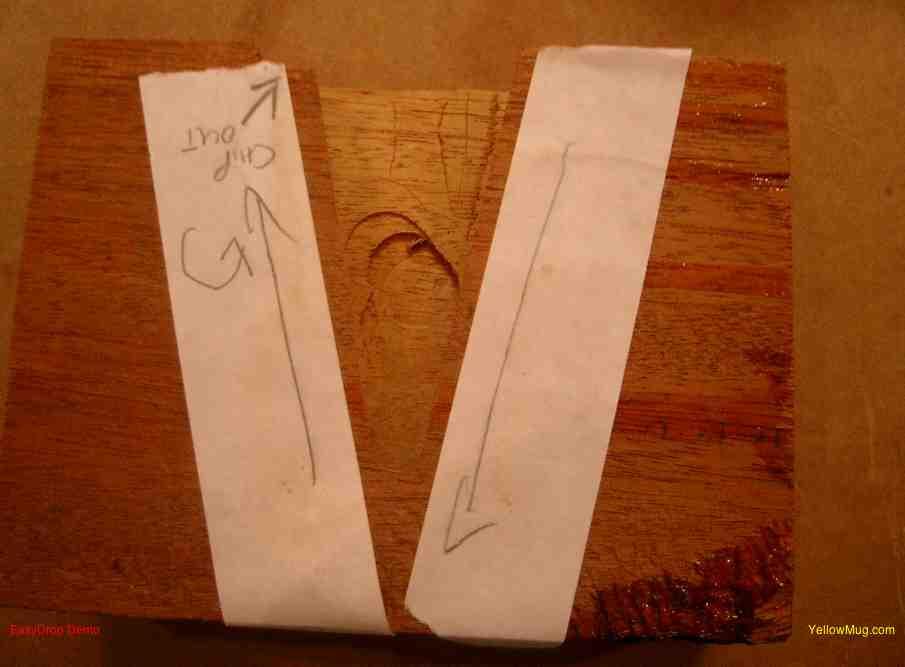

Ive managed to route up a half decent dovetail set on scrap mahogany. The fit wasnt perfect due to the bit slipping in the collet at one stage but I managed to shim things up with some veneer and the fit is pretty good.
The dummy heel block I used was routed at right angles to grain direction and there were problems with tear out on one side of the dovetail. As most heel blocks are glued in with grain running parralel to long axis of the dovetail I dont imagine this would normally be a problem. Any thoughts on avoiding such tear out if wished to install a heel block with grain oriented as in photos?

you do a short climb rout on that side.
as i recall, when s-m included the segment on the shop tips video they demonstrated using the dovetail bit for the whole task, rather than the more customary preliminary hogout with the straight bit.
remember that the mortise has to be about 1/8" deeper than the tenon's customary 3/4".

Will try a climb cut. I suspect grain orientation is the main problem as well as taking alot in one cut with the dovetail bit. On my guitars the grain of the heel block normally runs at right angle to sound board so I would expect less problems with run out.

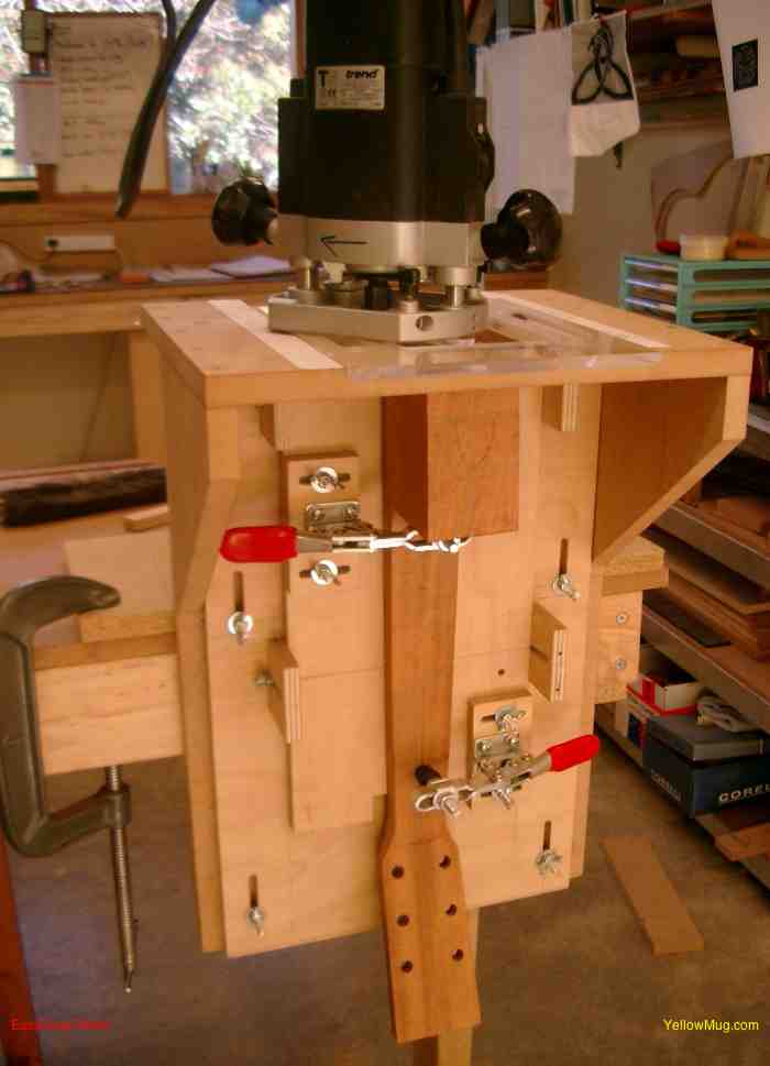

Okay I decided to make up a neck jig following photos in the LMI Catalog/handbook and heres the end product of 3 days of work. It hasnt got all the fancy plastic handled knobs and other fine touches like the one in the LMI book but it works.
kiwigeo38960.0142708333
PostPosted: Wed Aug 30, 2006 3:30 pm
WOW Martin, one nice jig!

Martin,
I am in just about the same point in the process as you. Do you have a jig for cutting the mortice in the body yet? I have been sketching things out for about a week now but I haven't decided how to go about it.
PostPosted: Thu Aug 31, 2006 1:41 am
as i mentioned in my posts above, the same jig can be used to cut both the mortice and the tenon. it of course has to be wider than the one shown immediately above, and has to have slots to be able to interchange the different holddowns used for the body.
why build two when one will serve both purposes?

Posts: 1055
Not sure whether or not to build a seperate cradle for routing the body mortise. Need to have a think about it first. Primary aim of the exercise was solving the problem of having to fiddle with multiple clamps to hold the neck in position. The body merely has to sit with mortise surface flush against the template...a bit easier to achieve than with the neck.

Michael, I can actually fit a dreadnaught body into my jig and get the mortise area sitting flush against the top of the jig. The neck clamping cradle can be pulled out and replaced with a suitable insert set up for holding the body secure. Still working on exact design of this.
PostPosted: Fri Sep 01, 2006 12:34 am
martin, i am surprized that it is wide enough given that you need room at the sides for the holddowns. the photos don't do it justice.
when doing the mortise it is very helpful for your mounting system to have have a pin, which can be accurately centered on the jig centreline, which engages the end pin hole. makes it easier to keep everything centred.
with enough width, the same tiltable mounting plate which is used for the neck can be used for the body by making the holddowns for the two parts interchangeable.crazymanmichael38961.4014236111

Posts: 1055
Yes, an end pin locater is an option. Dont think the main jig is long enough though. I built it from the Stewmac plans and I think they just expect you to use a couple of cam clamps in the waist area. In the LMI handbook Im using as a guide their body jig has an end pin locator.
Thanks for the comments and suggestions
